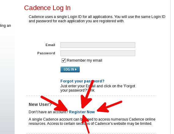

     one more thing is it possible to have access to cadence tool videos & turorials on cadence website with this community forum login details (username & password) or a separate one has to be created? If yes then please let me know the URL or procedure for the same.

    And for your second question, you can use your customer support login to reach the forums and other things on the site, but the forum login doesn't automatically give you access to the customer support site. To register you'd go to the support.cadence.com site and then use the (fairly obvious) "Register Now" link on the login page.
