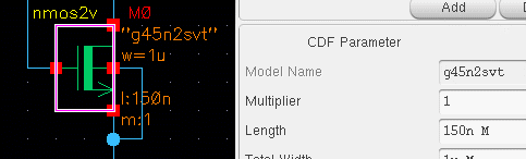

    The snapshot below shows an nmos and in the properties form on the right, we can see a "Model name" field. The actual name of the field is "model". "Model name" is just for display purpose. This field will be netlisted during spectre simulation so that the nmos takes on the model "g45n2svt". This is done through settings in the CDF (component description format). The user will need to include a model file in ADE that describes the contents of "g45n2svt". Otherwise there will be an error during simulation.
    You can import the verilogA files and automatically generate their symbols so that the symbols can be placed in a schematic and be connected with other blocks. Here is how you can do it:
    a. In library manager, go to "File->New->cellview"
    b. Select "verilogA" as the type of cellview
    c. Cut and paste the verilogA codes into the text editor
    d. Close the editor. There will be a dialog box to ask if a symbol should be generated.
    e. Select "Yes".
    f. Completed

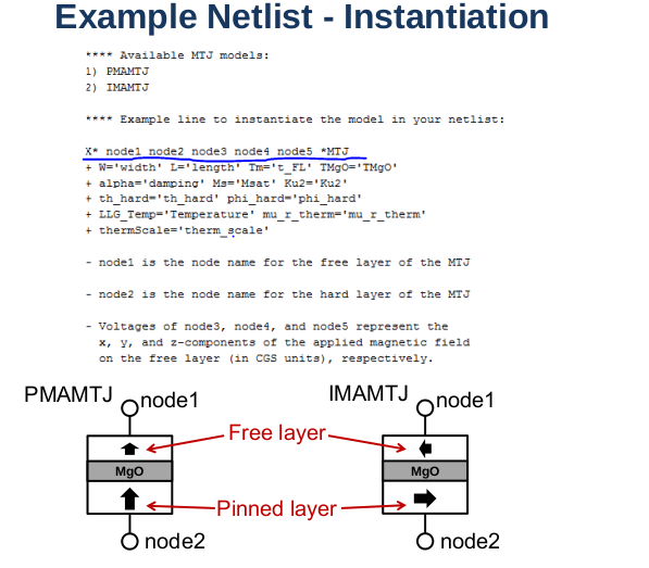

    I tried in library manager file->New->cellview........and then verilogA, but then  it reminds me .....failed. Might it because the cadence in my school doesn't support this function? Cadence in my school is not a full version, I found that several other functions mentioned by others on internet didn't work on the cadence here.
    I am thinking of  creating a symbol in Cadence with five terminals( it seems that the MTJ model uses five terminals, attached is the example netlist given on MTJ model). And then use this symbol in the ADE to perform simulation(need to include model file:  LLG.lib &MTJ.lib?).  Will this be possible? how should I do it?
    BTW, I did create a symbol with five terminals in the symbol editor, but it fails when I tried to create a netlist of it in the ADE environment.
    Thanks very much for your help!
