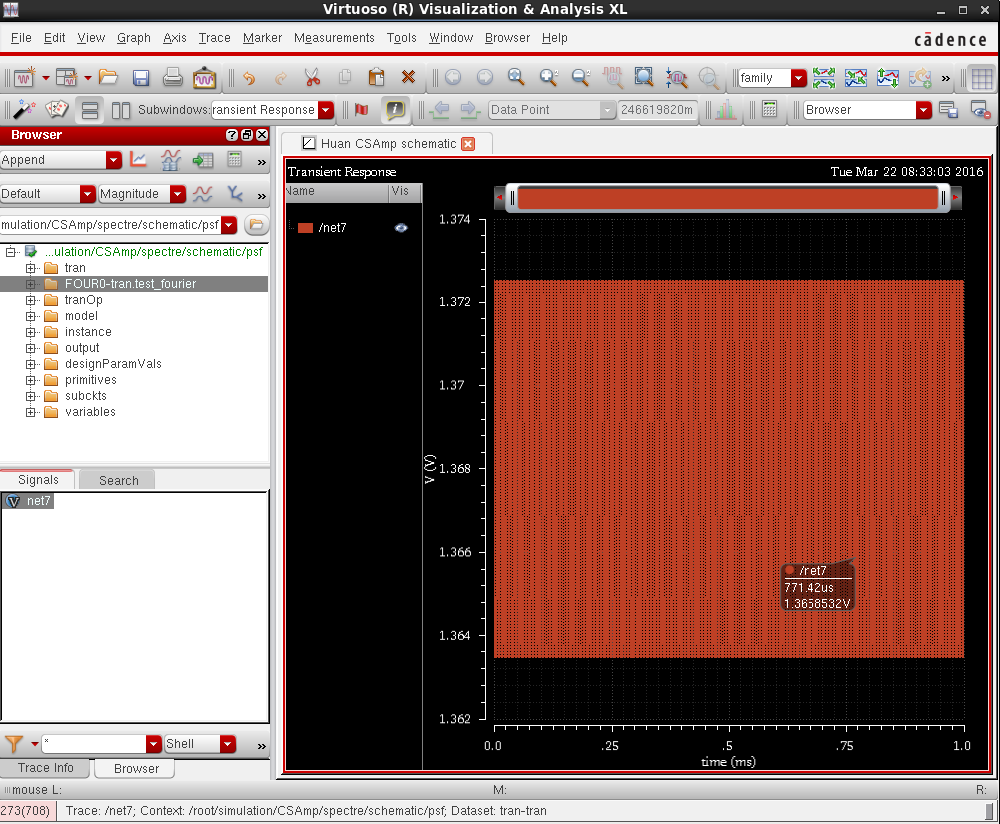

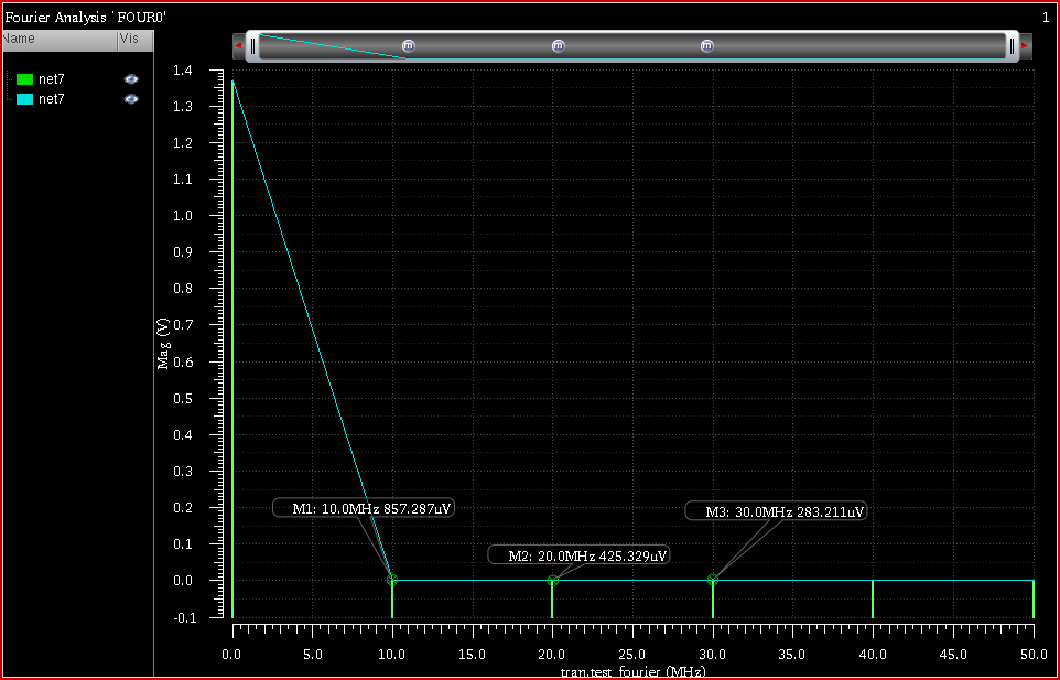

    I am having problems using the component in analogLib. I also tried model one in "spectre -h fourier" but I still doesn't work.
    I run transient of a common source amplifier and connected the output with fourier (connected drain with plus and negative of fourier with ground).
    When simulation end, I open psf file to plot signal. It is clear that there is the desired signal in fourier analysis folder but this signal has nothing, when I plot there is nothing in it.

    I used exactly the same MMSIM version as you (just in case) and got fourier results in the log file that matched yours (I found the same models). I then plotted the result in ViVA (both directly and then changing the plot style to spectral) and as you can see, the results are matching the log file:
    Which IC subversion are you using (Help->About in the CIW will tell you)?
  • BaaB
    BaaB over 10 years ago
    Thank you.
    The IC subversion: IC6.6-64b.500.9.
    "I then plotted the result in ViVA (both directly and then changing the plot style to spectral) and as you can see, the results are matching the log file."
    What do you mean by the results match the log file here?
    Also from my spectre.out:
    Fourier components of V(net7) for the interval from 999.9 us to 1 ms:
    DC = 1.36938 V.
    I am wondering why the interval is so short.
    I attached the picture below with about the result but net7 contains no data. The waveform shown is from transient analysis not fourier.
    I tried that version, and it works fine for me. How are you trying to plot the signal? If you plot the transient signal first, and then try to plot the fourier signal by dragging net7 from the fourier results onto the graph, that won't work because the axes are incompatible.
    If instead you double click on the net7 in the results browser, or select it and hit the plot icon, or select it and do Right Mouse->Plot Signal, then it should plot OK in a separate sub-window.
    I said it matches because the markers I added match these values (this is from my log file, but they match yours). I've marked in red the outputs I added markers for:
    Fourier Analysis `FOUR0'
    Fundamental frequency = 10 MHz.
    Fundamental period = 100 ns.
    DC = 1.36938 V.
    Harm: Absolute Absolute Relative Relative
    Magnitude Phase Magnitude Phase
    1: 857.287 uV -92.8791 Deg -0.000 dB 0 Deg <- normalizer
    2: 425.329 uV -92.9399 Deg -6.088 dB -60.8688 mDeg
    3: 283.211 uV -93.6285 Deg -9.620 dB -749.429 mDeg
    4: 212.374 uV -94.4755 Deg -12.120 dB -1.5964 Deg
    5: 169.935 uV -95.3875 Deg -14.057 dB -2.50841 Deg
    Total harmonic distortion = 67.5238 % (-3.41086 dB).
    RMS value of computed spectrum (excluding DC) = 1.03443 mV.
    RMS value of computed spectrum (including DC) = 1.36938 V.
    Nonperiodicity (first/last point mismatch) = 2.66335 mV (310.671 %).
    The reason why it is such a short interval is that you have a fundamental in the fourier analyser of 10MHz, which corresponds to 0.1us - and it analyses the last period during the transient, which is exactly what you're seeing. It would make no sense to have a longer interval unless the fundamental was a lower frequency.
    I already tried that but it doesn't work.
    By the way, I also sent the signal to calculator and then plotted it but calculator said the expression is nil. So I think there is something wrong with the signal here. It doesn't have any data.
    Is there a way to plot the signal in fourier with the data given in log file?
    I have no idea why this doesn't work for you, when it works absolutely fine for me with the same netlist, same simulator and Virtuoso versions.
    Can you (in UNIX) go into the psf directory and type:
    psf FOUR0.tran.test_fourier
    and post the output here.
    No, you can't plot the log file (that's pretty obvious, I would have thought). You could put the numbers in a file and use the getAsciiWave function in the calculator to read it (it would have to be a set of x,y pairs in the file you're reading) but that's pretty clunky.
