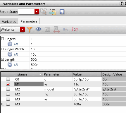

Is it somehow possible to store design variables of a cell in a config-like cellview or file?
Here is what I mean: Suppose I design a simple opamp for I which create a triangle symbol view and use it in many other places. Now when I design the amplifier I have all the widths, lengths, bias currents in my ADE L view as Design Variables. I can sweep them until they match and then I fix them. Now, 2 weeks later I need to change the amplifier. I need to replace all the static values by design variables, design the amplifier and re-replace the values again with their static values.
This is extremely error prone (and I always make mistakes), particularly since so many values are interrelates (e.g. the widths in a differential configuration are the same and the biasing branches are just some multiple).
What I envison is some sort of pPar which takes the actual values from a config file or config cell view. Then it's also way easier to keep an overview on the design and archive specs.
What I do not want: Store the values in an scs file and use "Simulation files". It just does not work because ADE L always imports the design variables into the window and then simulation fails if if they are not set (and if they are set, they overwrite the values from the scs file). Supposedly copyDesignVarsFromCellview should fix this (see

    The other thing you can also do with the Variables and Parameters assistant is save sets of variable/parameter values (or sweeps) to a "setup state". That's the box and icons at the top of the image that Quek shared. Then it's easy to switch back and forth between fixed global variables and sweeps, or to enable certain combinations.
    Also the parameters can easily be set up to be matched parameters between a group of devices (without having to put variables on everything), or you can setup "ratio" parameters (such as when you've got a value with is N times another and you want to maintain that ratio whilst sweeping the unit value).
    If it was just a matter of recording a set of variables, then of course you could do that with ADE L - you just need to save the state and just save the variables. However, the problem with that is that  you need to modify the schematic to reference all these global variables, which is awkward and hard to maintain. As Quek said, the parameterisation capability in ADE XL (and ADE Explorer and Assembler in IC617) means you don't have to edit the schematic at all; you can override values without actually modifying the schematic at all. Once you're happy with a result, you can backannotate the values onto the actual schematic (i.e. update the schematic to reflect the values you're happy with).
