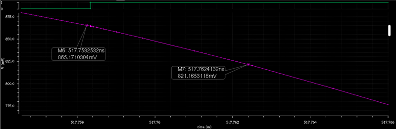

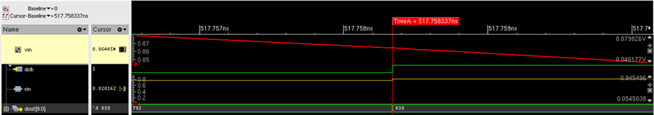

Here is a particular sampling instant:
There is a difference of 40 mV between V(vin) and the sampled value rin, which is unacceptable for my application.
I also checked the computed points and observed a cluster of points near the rising clock edge, but the sampled value occurs quite far away from this edge:
The time difference between those two samples is more than 4ps, but I use a timescale precision of 1fs in all my Verilog and Verilog-AMS modules in the netlist, so I have no idea where this error comes from.
Do you have any idea on the cause and solution of this abnormality? Or an advice on how to further debug?

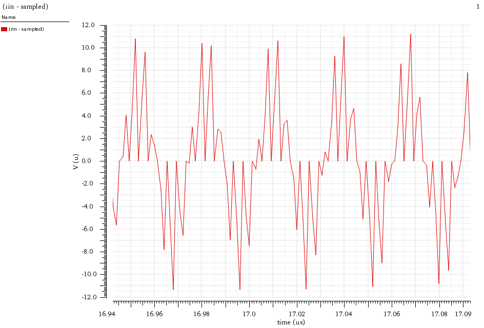

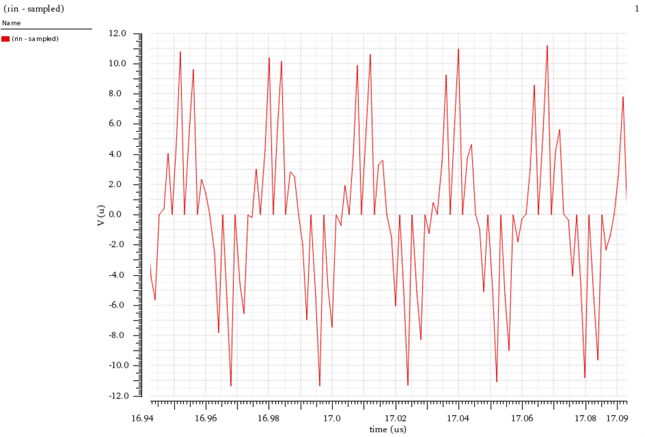

    Hi Arda,
    I ran your example with INCISIVE152 (as that was the version I had to hand). I ran the full 85us that you had in your example, and then wrote some SKILL code to sample the input signal IN at the points where the signal rin changes (i.e the clock edges), and then took the difference and plotted that. Here's the code I used:
    *               abSampleByReal(realWave contWave)                *
    *   The first argument is a real number waveform (i.e. sample    *
    *  and held, with time points only when a new sample is taken).  *
    *  This function samples the second waveform (continuous time)   *
    * at the instants in time where the real waveform changes (which *
    *              should be on the clock transitions)               *
    procedure(abSampleByReal(realWave contWave)
        let((rXVec rYVec cXVec cYVec rLen cLen oYVec rX rY cX cY oY
                cXprev cYprev cInd)
            rXVec=drGetWaveformXVec(realWave)
            rYVec=drGetWaveformYVec(realWave)
            cXVec=drGetWaveformXVec(contWave)
            cYVec=drGetWaveformYVec(contWave)
            rLen=drVectorLength(rXVec)
            cLen=drVectorLength(cXVec)
            oYVec=drCreateVec('double rLen)
            cInd=0
            ; this is a cheat just to prevent first point in waveform
            ; being wrong because real value hasn't sampled yet
            drAddElem(oYVec drGetElem(rYVec 0))
            ; Loop through each remaining sample point and linearly interpolate
            ; the continuous waveform at the sample points
            for(ind 1 rLen-1
                rX=drGetElem(rXVec ind)
                rY=drGetElem(rYVec ind)
                cX=drGetElem(cXVec cInd)
                cY=drGetElem(cYVec cInd)
                while(cX<rX && cInd<cLen
                    cXprev=cX
                    cYprev=cY
                    cInd++
                ; linearly interpolate or if no previous point
                ; just output directly
                oY=
                    if(cXprev then
                        (cY-cYprev)*(rX-cXprev)/(cX-cXprev)+cYprev
                    else
                        cY
                drAddElem(oYVec oY)
            drCreateWaveform(rXVec oYVec)
    The OCEAN script to do the plotting was this:
    load("abSampleByReal.il")
    openResults("psf")
    selectResult("tran-tran")
    IN=v("test_timestep.IN")
    rin=v("test_timestep.ADC.rin")
    sampled=abSampleByReal(rin IN)
    plot(rin-sampled)
    The resulting waveform (zoomed in so you can see the detail) looks like this:
    It's the same all the way through - the peak is no more than about 10uV difference, so tiny - given that you are under sampling the input waveform (so it's changing rapidly) this is insignificant, I think. Certainly not the 40mV you were talking about.
    Perhaps it was a bug in the rather old INCISIVE version you were using? Not sure - I'd try with something more recent...
