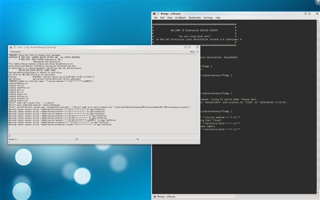

After launch icfb, I got the following error:
 X Error of failed request:  BadName (named color or font does not exist)
  Major opcode of failed request:  45 (X_OpenFont)
  Serial number of failed request:  15
  Current serial number in output stream:  30
could someone help?
thank in advance.
JM.

    It would be great to have some more information about the hardware/OS and the icfb version
    For a start you could try this:   icfb -nosplash

  • jmcal
    jmcal over 8 years ago in reply to Andrew Beckett
    yes, i did. I got icfb window as in the picture, can't do anything more with...
  • Marc Heise
    Marc Heise over 8 years ago in reply to jmcal
    You seem to miss all the adobe fonts we try to use.  You can check if they are available with:  xlsfonts | grep adobe
    Some admin needs to install them.  Maybe you should also run a
    checkSysConf    ( $CDSHOME/tools/bin/checkSysConf IC5.1.41)
    to see if your system libs are up to the task.
