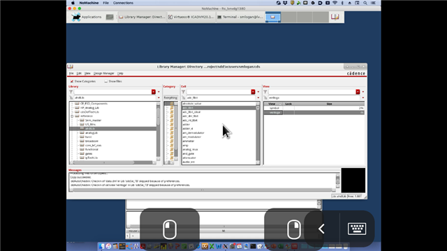

    Dear Kulmani,
    Within the Cadence ahdl Library (included in your Cadence installation - refer to Figure 1 -there is an 8 bit ADC which uses 8 input comparators whose name is adc_8bit. Hence, this in effect models a flash converter. You might consider using this in lieu of your veriloga model - or perhaps modify it to meet your needs. From the header information in the
    // This ADC comprises 8 comparators. An input voltage is compared to
    // half the reference voltage. If the input exceeds it, bit 7 is set and half
    // the reference voltage is subtracted. If not, bit 7 is assigned zero
    // and no voltage is subtracted from the input. Bit 6 is found by doing an
    // equivalent operation comparing double the adjusted input voltage coming
    // from the first comparator with half the reference voltage. Similarly
    // all the other bits are found.
    // Mismatch effects in the comparator reference voltages can be modeled
    // setting 'mismatch' to a non-zero value. The maximum mismatch on a
    // comparator's reference voltage is then +/-'mismatch' percent of
    // that voltage's nominal value.
    Shawn
    Figure 1

    Thank you Shawn for your reply. That helped a ton for references. But i am not sure that they have implemented a Flash ADC there as they are substracting the reference voltage and the doubling up the voltage whereas in a Flash ADC we compare the analog inputs with references to generate a decimal thermometric code and then encode it into desired bits. Found the could a bit confusing or maybe i couldn't understand well. But thanks for pointing out the library, i can take a lot of references from there now :)
    Kulmani
  • ShawnLogan
    ShawnLogan over 5 years ago in reply to Kulmani
    Dear Kulmani,
    You are absolutely correct...I did realize that but thought since it was an "ideal" model of a converter it might accomplish what you needed. Perhaps you wanted access to the thermometer code as the output. Obviously, that implementation will not provide a thermometer code - it's topology is more of a SAR. In any case, the veriloga code examples in the library are helpful and am glad you found the library!
