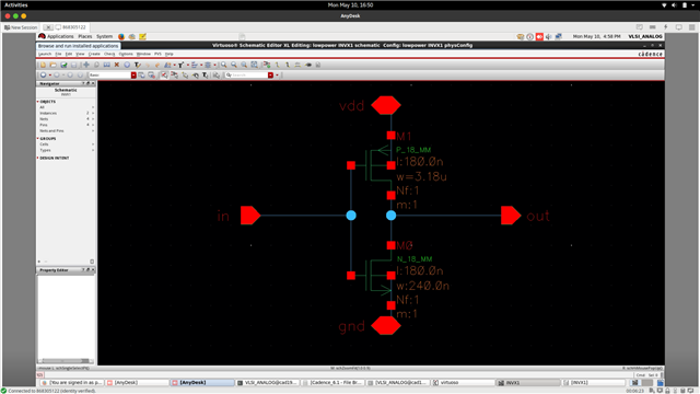

My progress till now:
1) Draw the schematics of all the cells that I want to include in the library
2) Generate the symbol view for each of these cells
3) Draw the layouts for each of these cells
I tried going into ADE L and Simulation->Netlist->Create as per the documentation I read using my COS account, this gives me a spectre netlist. But when I try to save this netlist to the spectre view created using Create->Cellview from Cellview it says there were errors parsing the spectre file, but the errors/warnings don't show up. An empty error window opens up.

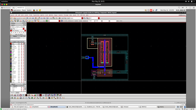

  • iamKarthikBK
    iamKarthikBK over 5 years ago in reply to Guangjun Cao
    I am using Assura Quantus for Parasitic Extraction, and I'm ending up with a few errors. Can you please help me understand as to where I could be going wrong?

    Here's the log file:

  • iamKarthikBK
    iamKarthikBK over 5 years ago in reply to iamKarthikBK
    Here are screenshots if in case the net names are confusing :)
  • iamKarthikBK
    I haven't named the nets as 'gnd!' but only as 'gnd'. Same with 'vdd' being named as 'vdd!'. Andrew Beckett Guangjun Cao can you please tell me as to why that happens?
    What does /S_mustGroup_0/vdd! and /D_mustGroup_1/gnd! mean?
    I am using UMC's 180nm FDK
    Thank you so much for your time and patience in advance, I sincerely appreciate it!
