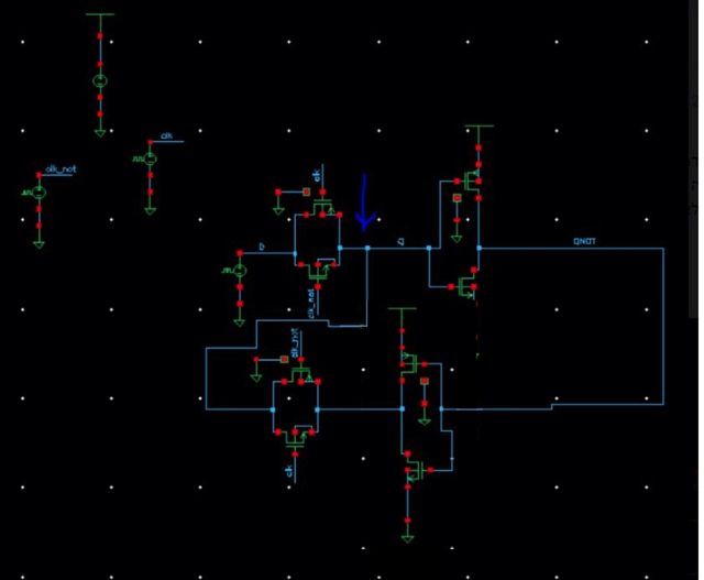

Hello , i am trying to build an RF frequency D FlipFlop as shown bellow.
On the node Q signed by blue arrow i get a very abnormal charge and discharge behavior.
On the first TG opening Q charges half the way. When TG closes, it charge Q till the end although its not suppose to charge at all at this step(closed TG) ,as shown  in the last plot bellow.
Is there a way to see  how much capacitance we have on node Q when TG opens?
Thanks.

    Hi Yefj,
    I  added some labels to better explain my comment.
    If I understand your comment, and TG is the top most transmission gate, it appears TG1 (the bottom most transmission gate) operates on the complementary clock version of clk/clk_not. Hence, when TG assumes its high-impedance state, TG1 assumes its low impedance state and the charge on node Q serves to charge up your unlabeled gate node Q2. Hence, between the charge that flows to Q2 and the charge injection of opening and closing TG and TG1, it is expected that the node voltage of node Q will change.
    Does this make sense Yefj? You can minimize the change by added a signficant capacitor to node Q.
    Shawn

  • FormerMember
    FormerMember over 7 years ago in reply to yefJ
    yefJ said:
    is there an article  with Cadence virtuoso implementation where i cant see how to plan a TG that will get threw my data  when the clock rises?
    If I understand your initial objective, which you stated as "i am trying to build an RF frequency D FlipFlop as shown bellow", I think there is an error in your schematic diagram. I have modified your diagram and included it below to illustrate what I think you need to simulate. When your input TG is low impedance, TG1 is high impedance and node Q will charge to the D input voltage and the output of the inverter with input Q will be QN. When input TG becomes high impedance, TG1 will become low impedance and it will allow the feedback inverter to force node Q to the voltage it had when TG was low impedance.
    Does this make more sense now yefj?
