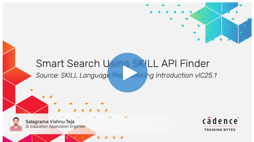

Don’t worry about memorizing every SKILL function. Use the built-in SKILL API Finder: just type your question in plain English, and it will show you the right SKILL function, its attributes, and how to use it. To learn more about this tool, watch the Smart Search Using SKILL API Finder video on the Cadence ASK Page.
The new Smart Search in Virtuoso Studio lets you look up SKILL functions using everyday language. It combines keyword and natural language searches, gives quick results, and explains what each function does—helping everyone get answers quickly.

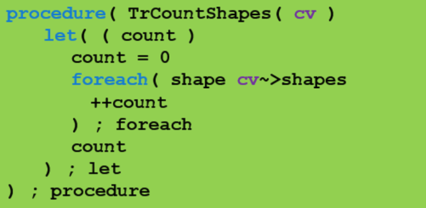

Here is a small SKILL code snippet to count the number of shapes in a layout:
By seeing the code, you can get the task that is being done.
In the above example,
  • cv is the current layout cellview
  • count is the variable set to zero
  • foreach loop iterates through each item in the given list
  • For every shape, the variable count gets incremented
You can improve this code by filtering each type of shape, resizing a specific shape, and many more. Such automation can save hours when generating via arrays in high-density layouts.
