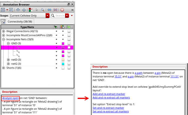

In Virtuoso Layout Suite, connectivity analyzer helps you analyze reported connectivity markers and, when appropriate, guides you toward fixes that can be applied directly from the tool. For each reported marker, the tool helps determine whether the violation is expected or unexpected.
You can select a reported connectivity marker in Annotation Browser and analyze it to understand why the violation was flagged and whether it represents a real issue or an expected condition. To do this, click the analyze link in the marker description or right-click the marker and select analyze marker. The analysis updates the marker description with detailed insights and, where applicable, adds fixer links that guide you directly to recommended actions.
When a violation is unexpected, the connectivity analyzer suggests a fixer. Selecting a fixer resolves the issue and, if needed, adds an override to the connectivity overrides file. Connectivity markers are then re-extracted as required, and the overrides are applied during subsequent extractions and to new cellviews.
Supported Connectivity Issues and Fixes
Open markers may be reported when shape visibility is insufficient during extraction. After analysis, a fixer is provided to add an extract stop level override, extending shape visibility and resolving false open violations.
Short markers can occur due to incorrect connectivity assignments on instance terminals. After analysis, the tool identifies the path causing the short and provides fixers to reassign instance terminals to the appropriate net and locate the short on the layout canvas.
Illegal hierarchical connection markers are reported when a connection exists between a top-level net and an internal net. If the connectivity is intentional, analysis provides a fixer to add an override that ignores the corresponding hierarchical shape connectivity.
Incomplete must-connect-all-pins markers are reported when no physical connection exists between the pins of a must-connect-all-pins terminal. Analysis explains the issue and provides a fixer to add a terminal override, resolving the marker during re-extraction.
