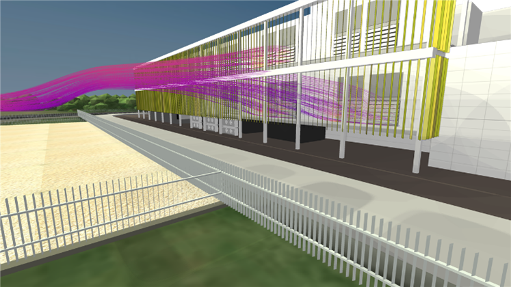

Kao Data – Hyperscale-Grade Free Cooling with CFD-Driven Validation
High-density computing need not compromise energy efficiency, and Kao Data’s London One campus demonstrates this clearly. Designed for HPC and AI workloads with rack densities of 25kW to 40kW, the facility uses refrigerant-free indirect evaporative cooling to achieve 100% free cooling and a PUE below 1.2.
Using the Cadence Reality Digital Twin Platform, Kao Data built a physics-based digital twin to model internal halls and external conditions before construction. This simulation-first approach validates airflow, inlet temperatures, cooling resilience, and performance under full and partial loads without risking live equipment.
The result is an industrial-scale data center delivering a PUE of 1.2 even at low IT utilization and 1.14 at 50% load, offering long-term operational savings and flexibility for future growth.

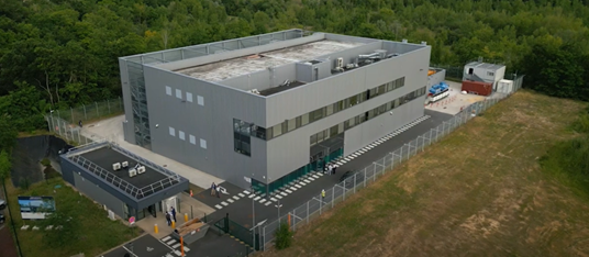

Thésée DataCenter – Operational Digital Twins for Capacity and Reliability
While Kao Data primarily used digital twins for design validation, Thésée DataCenter extended the concept into day-to-day operations. Each hall within the Tier IV-certified facility is paired with a dedicated digital twin modeled using Cadence Reality Digital Twin Platform, which continuously models capacity, power distribution, and cooling behavior. During the design phase, the twin validated high-density layouts and failure scenarios; in production, it remains integrated with the DCMS portal to predict how mixed-rack densities and changing customer loads affect thermal margins and redundancy compliance.
This operational twin allows both the provider and its customers to interact with a 3D virtual replica of their deployed space, test expansions virtually, and forecast the impact of densification or maintenance events without disrupting service. The result is not just better planning, but a continuously optimized colocation environment where reliability and efficiency are engineered in rather than managed reactively.

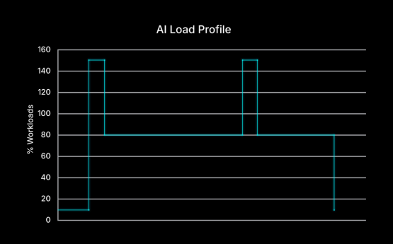

AI load profiles fluctuate massively within milliseconds, presenting major power and cooling challenges
AI infrastructure has pushed data centers beyond the limits of traditional air-cooled design. GPU and accelerator clusters often exceed 50kW to 100kW per rack, creating extreme heat flux, transient loads, and localized hotspots that make airflow behavior highly nonlinear and unpredictable. At these densities, small layout or containment changes can trigger throttling or hardware failures, making deterministic, physics-based modeling an engineering necessity rather than an optimization step. An AI data center digital twin provides multiphysics visibility into coupled thermal, liquid, and electrical effects that static planning cannot capture.
By integrating CFD, liquid cooling thermal models, and electrical power-flow analysis with live telemetry, the twin predicts coolant performance, airflow distribution, and rack-level headroom before deployment. Engineers can mitigate risks, validate densification, and tune cooling to keep accelerators operating at peak efficiency. Digital twin modeling platforms offered by Cadence enable this predictive workflow, turning digital twins into operational control systems for reliable, high-density AI environments.
