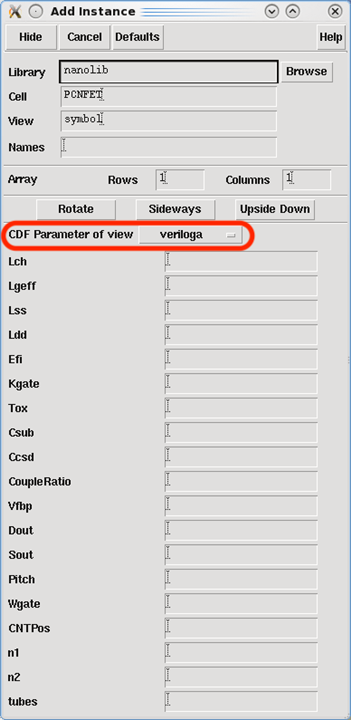

Im trying to make symbol using verilog A, the design is actually formed using 3 files; so in the beginning I have included the file using " 'include abd.vams" but while compling it seems that its to able read that file? One of the file is written in verilog-ams.
Am I missing any step?
Thank you in advance

    Andrew Beckett over 8 years ago in reply to Shobhitkareer
    OK, I tried this - admittedly using IC617, but it should be the same in IC5141 (not sure why you need to use such an old version if this is something new... IC5141 came out in 2004, and the very last hotfix was in 2011)
    Anyway, what you have to do is set the env var that Dimitra mentioned early in this thread to include the directory where the parameters.vams file is. In my case I did:
    setenv CDS_VLOGA_INCLUDE $PWD/nano_model_35
    The I created three cellViews:
    • PCNFET_L1 : include files left as-is - so the entire content was as it was in the download from Stanford
    • PCNFET_L2 : remove the `include "PCNFET_L1.va" but add `include "parameters.vams" instead.
    • PCNFET : use the code from the file PCNFET_L3.va, but remove the `include "PCNFET_L2.va" and add `include "parameters.vams" instead
    Symbols then get created (and CDF) for each of the three cells, and if I instantiate PCNFET in a schematic and netlist to spectre in ADE, I get (at the bottom of the netlist):
    ahdl_include "/export/home/user/support/forum/nano/nanolib/PCNFET_L2/veriloga/veriloga.va"
    ahdl_include "/export/home/user/support/forum/nano/nanolib/PCNFET/veriloga/veriloga.va"
    ahdl_include "/export/home/user/support/forum/nano/nanolib/PCNFET_L1/veriloga/veriloga.va"
    So the netlister automatically includes all the right pieces into the spectre netlist.
    So as I said, you should not include the lower modules into the higher modules. There's no need.

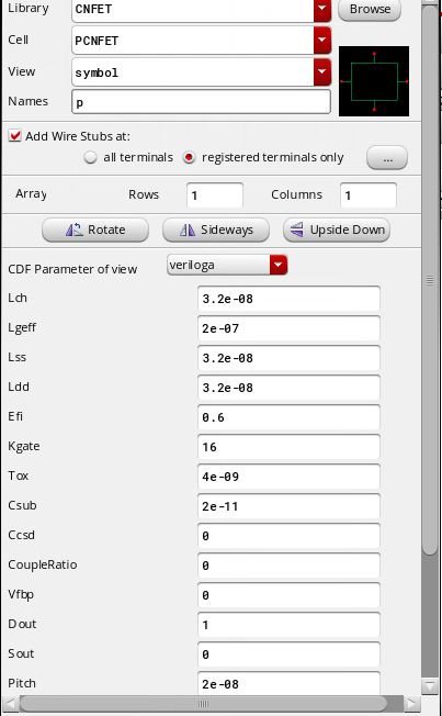

    I tried this in IC5141 yesterday (admittedly I was using MMSIM11.1 rather than MMSIM7.2 that you were using, but I doubt that makes a difference) and it works fine. I'm using subversion 5.10.41.500.6.151).
    In terms of the CDF parameters being shown, this works fine - you just have to click on the "CDF Parameter of view" cyclic field to show them:
    Note that you should check your netlist (Simulation->Netlist->Display and see if you are getting the three ahdl_include lines). If you're not, maybe you're using an old subversion of IC5141 which had a bug? If so, what are you using (type getVersion(t) in the CIW to get the subversion and post it here). Have you removed the include of the lower level modules in the higher level modules?
