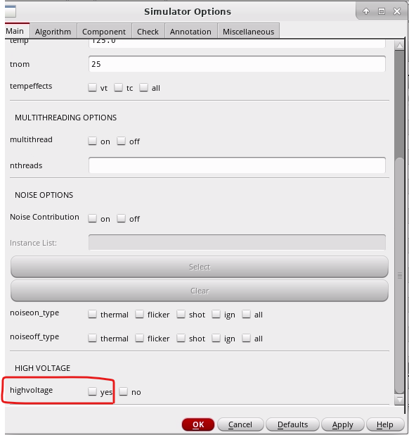

    3. Are you using the "highvoltage option" (see Figure 1)? The use of this option can improve simulator accuracy as your voltages are rather large (13 V difference in your case). From the Cadence help menu:
    "To improve the simulation accuracy of high-voltage circuits (where the maximum voltage is greater than 10 volts), or circuits that have convergence issues and report large capacitance values in the log file, you can set the highvoltage parameter in the options statement to yes"

    3. In my cadence virtuoso-simulator options, highvoltage option does not exist. (see Figure 1.)
        Figure 1
        [ My cadence version : virtuoso version 6.1.7-64b , sub-version : IC 6.7.7-64b.500.12]
    Therefore, I think I may revise voltage pulse (10 V DC, 10 V pulse).
    What do you think, Shawn?

    Shawn's points about the bulk current don't make sense here - that wouldn't affect Kirchoff's law; it would be relevant if you were looking at the currents into the drain/gate/source of the same MOSFET as summing these may not add to zero as some current goes to the bulk. However, that's not what you're doing here - you're looking at all the current contributors onto the same node from three different MOSFETs.
    Similarly the "highvoltage" option is to help with controlling accuracy at a reasonable cost (cost in terms of simulation time). That's because when simulating transient with errpreset=moderate, it uses the largest signal anywhere in the circuit to control the maximum allowed error on each node, and so having high voltages can reduce the accuracy on low voltage nodes. Often people switch to conservative in such cases (which uses the highest voltage on each node to set the allowed error for that node), but that will take more time steps and be slower. The highvoltage option simply means you can use the same moderate option (without a major penalty in terms of increased time steps) but allow a bit more granularity in determining the allowed error (it uses bins of voltage ranges). Either way, that's not the issue here - so I don't think your voltage pulse has anything to do with this.
    This was the motivation for my possible suggestion that yysunj :
    Obviously, this comment was not clear - and for that again I am sorry!
