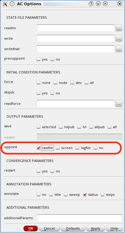

    Dear Elhossiny,
    Elhossiny said:
    how to get Cgg using AC analysis
    Is your AC analysis GUI oppoint set to select "raw" as shown in the GUI panel a the Cadence On-line Support portal at URL:
    https://support.cadence.com/apex/ArticleAttachmentPortal?id=a1O3w000009xz7xEAA&pageName=ArticleContent
    If you are not running a DC operating point analysis with your AC analysis, and want to examine operating point parameters (no node voltages) oppoint must be selected as "raw".
     Did you try this?
    Shawn

    Dear Elhossiny,
    > I cant open the pervious link
    Please consider getting a Cadence support account Elhossiny as there is a wealth of information on the site that I think you will find helpful. The account will provide access to the link. I have attached the relevant GUI AC analysis panel as Figure 1.
    > I want to get Cgg vs VGS, but using dc analysis only.
    I am confused. Your initial post and question suggested to me that you were only running an AC analysis only and wanted to find Cgg from the analysis without running a DC analysis. Did I misunderstand?
    > I tried V = I/(jwC), so C = I/(2πfV ), and
    > assume f=1hz, but dont give me right cgg,
    > can u tell me how to apply this equation
    > to draw C-V curve use AC analysis.
    If you are trying to determine the C-V curve, you need to have a test bench to do this. You can not expect a single AC analysis to provide the C-V curve. I have described such a test bench in the past in this forum numerous times to examine the C-V relationship of any arbitrary two terminal device.
    Is this what you want to do?
    Figure 1
