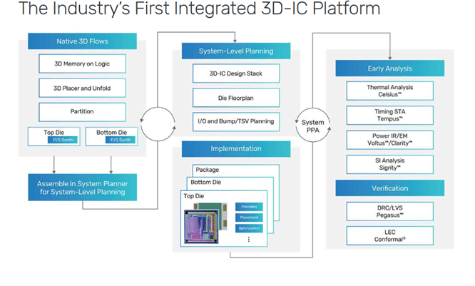

Tool Flows for Architectural Exploration
As integration grows more complex, EDA workflows must unify the way teams plan, assemble, analyze, and sign off on multi-die systems. The Cadence Integrity 3D-IC Platform addresses these needs with:
  • System-level architecture exploration and floorplanning
  • Package-aware parasitic extraction
  • Thermal and structural analysis
  • Signal and power integrity co-analysis
  • Multi-die assembly checks and verification
  • Co-simulation across dies, interposer, and package
Tool Flows for Architectural Exploration Integrity 3D-IC PlatformA single integrated environment helps teams evaluate architectural tradeoffs early, identify thermal or IR-drop risks, accelerate convergence, and reduce schedule uncertainty.
