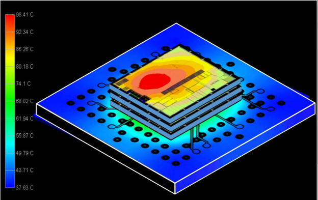

Thermal Modeling
Effective thermal management now begins at the architecture definition stage, where designers evaluate stack feasibility, power distribution, and allowable thermal envelopes before committing to partitioning decisions. These early insights directly shape block placement, power-delivery topology, and the choice of materials, interposers, and packaging technologies. As the industry increasingly relies on vertically integrated systems to achieve performance-per-watt gains, thermal awareness emerges as an architectural discipline in its own right, one that guides every subsequent stage of the 3D-IC design flow.
This article guides modeling, estimating, and mitigating thermal challenges in dense stacks and interposer-based 3D-ICs, with an emphasis on early electrothermal strategies that scale with complexity.

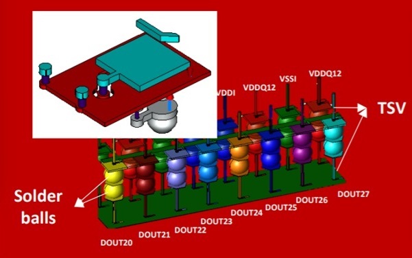

3D EM Modeling
Creating usable power maps at this stage does not require full register transfer level (RTL) activity vectors. Coarse workload profiles can yield first-order estimates of dynamic and leakage power. When combined with simplified geometry models, they highlight thermally sensitive regions, enabling design teams to adjust block partitioning, die assignment, and approximate placement before entering the detailed implementation phase.

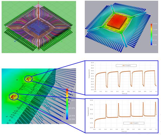

 SI and PI Simulation
Cadence’s multiphysics system analysis ecosystem connects power estimation, compact thermal model (CTM) modeling, and system-level thermal analysis, ensuring that signal, power, electromagnetic (EM), and thermal assumptions remain aligned throughout the early design phase. This early visibility reduces late-stage thermal surprises, which are often the costliest to rectify.

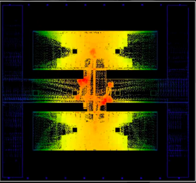

Co-Optimization with Placement and PDN Design
The PDN adds additional complexity. Power delivery structures, including TSVs, bumps, and interposer redistribution layers, introduce their own resistive heating. When modeled jointly with thermal effects, the combined electro-thermal behavior reveals interactions that neither analysis can capture alone. Co-optimization across these domains ensures that thermal mitigation does not compromise power integrity and vice versa.
A tightly integrated workflow enables round-trip refinement as power, placement, and package assumptions evolve. Without this iterative co-design, late-stage violations become inevitable, requiring disruptive redesigns.

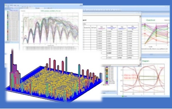

Electro-Thermal Readiness
Die-to-die boundaries, micro-bump arrays, TSV clusters, and package interconnects must be evaluated holistically, since minor thermal mismatches can accumulate into significant mechanical strain. Long-term reliability also depends on understanding how temperature interacts with electromigration, aging, and performance drift over the product lifetime.
A complete electro-thermal signoff process provides the confidence needed before entering manufacturing, reducing field failures and ensuring long-term stability.
