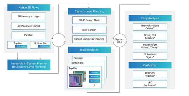

Known Good Die (KGD) and Yield Management
The economic viability of 3D-ICs hinges on the ability to assemble only KGD. Once chiplets are stacked using micro-bumps or hybrid bonding, the ability to rework is extremely limited, and a single defective die can render an entire package unusable. As a result, KGD testing is a central pillar of yield management in 3D-IC technology, particularly for high-cost AI and HPC packages.
Known Good Die
Pre-Bond Test Limitations
Achieving true KGD status is more complex than in a traditional wafer test. Wafer-level probing for chiplets must contend with:
  • Limited probe power delivery and reduced noise margins
  • Restricted thermal coverage for hot and cold testing conditions
  • Die-to-die interfaces (e.g., UCIe or proprietary links) that are not designed to directly drive external test equipment
Because of these limitations, KGD strategies typically rely on a carefully balanced combination of structural test, parametric screening, and built-in self-test (BIST) rather than full functional coverage at wafer sort. Pre-bond and post-bond test flows must be co-optimized to maximize defect detection before stacking.
Yield Amplification Risk
Yield loss in stacked designs is multiplicative. Latent defects in TSVs, micro-bumps, or hybrid bonding interfaces may not manifest until after stacking or reflow, dramatically amplifying cost impact. This reinforces the industry’s well-known “rule of ten” economics: Detecting defects as early as possible reduces downstream cost by an order of magnitude at each stage.
Cadence’s Integrity 3D-IC Platform supports yield-aware planning by enabling early analysis of interconnect density, TSV placement, power delivery paths, and thermal constraints—helping teams design stacks that are inherently more testable, manufacturable, and resilient to yield loss.

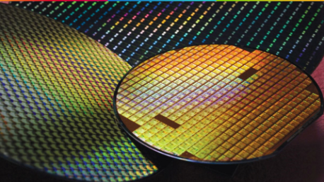

Die-to-Die Link Testing and Access Standards
Testing of 3D-IC technology does not stop at individual dies. Die-to-die interconnect testing is essential for validating signal integrity, continuity, and performance of vertical and lateral links once dies are assembled, particularly for high-speed chiplet interfaces.
IEEE 1838 and Standardized Test Access
The IEEE 1838 standard defines a scalable test access architecture for stacked dies, introducing:
  • Die wrappers to isolate individual dies during test
  • A serial control mechanism for accessing embedded test logic
  • Optional flexible parallel ports for higher test bandwidth
The standard works in concert with the IEEE 1149.1 (boundary scan) and IEEE 1687 (IJTAG) standards, enabling structured DFT for multi-die systems while maintaining compatibility with existing test infrastructure. This approach is increasingly relevant for UCIe-based die-to-die links, where standardized access is critical for interoperability and yield learning.
Access Architecture Implications
In 3D-ICs, test access architecture must be planned alongside physical and package design. Decisions around wrapper placement, access routing, and test bandwidth directly affect routing congestion, power integrity (PI), and thermal behavior. Post-assembly test, therefore, becomes a system-level tradeoff, not a back-end afterthought.
Cadence’s system-aware design environment allows architects to evaluate test access feasibility early, aligning DFT strategies with package routing, interposer constraints, and die-to-die signaling requirements.

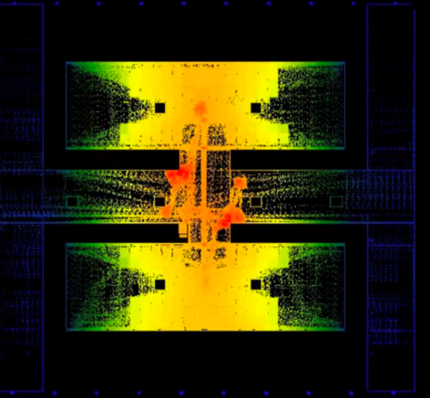

Thermo-Mechanical Stress, Warpage, and CTE Issues
Reliability challenges in 3D-IC technology extend well beyond electrical behavior. Thermo-mechanical stress arises from the interaction of dissimilar materials under temperature cycling during wafer thinning, bonding, reflow, and real-world operation.
Stress Drivers in Stacked Designs
Key contributors include:
  • Coefficient of thermal expansion (CTE) mismatch between silicon, copper TSVs, underfill, and substrates
  • Wafer thinning and bonding-induced residual stress
  • Non-uniform power dissipation across stacked dies
These effects can result in warpage in stacked dies, die cracking, delamination, and fatigue failure in solder joints, TSVs, or hybrid bonds—directly impacting long-term reliability.
Design-Time Mitigation
Addressing the mechanical reliability requires early modeling and layout optimization, including:
  • TSV and bump placement optimization to balance stress distribution
  • Selection of low-CTE underfill and bonding materials
  • Substrate thickness, stack height, and assembly tradeoff analysis
Multiphysics simulation—combining thermal, mechanical, and electrical analysis—is essential for predicting failure risk before silicon fabrication. Cadence workflows support this co-analysis approach, enabling teams to identify high-risk regions early and refine stack architecture accordingly.

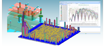

EM/PI Risk in Vertical Current Paths
EM/PI Risk
As power density increases, electromigration (EM) and power integrity challenges become more severe in 3D-ICs, particularly in vertical current paths supporting AI accelerators and high-performance compute workloads.
Vertical Power Delivery Challenges
High current density through TSVs, micro-bumps, and hybrid bonds increases susceptibility to:
  • Electromigration-induced voiding
  • IR drop and localized power rail collapse
  • Ground bounce and coupling noise between adjacent vertical structures
Unlike planar designs, failures in vertical interconnects can compromise multiple dies simultaneously, accelerating system-level failure.
EM/PI Analysis as a Reliability Requirement
Preventing EM risk in TSVs and hybrid bonding requires accurate modeling of current density, temperature coupling, and material limits under realistic operating conditions. Cadence’s SI/PI and EM analysis capabilities, integrated with the Integrity 3D-IC Platform, enable designers to assess vertical current path reliability using physics-based models rather than idealized assumptions.
