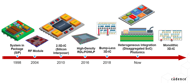

As process nodes continue to advance into the sub-micron era, the limitations of traditional scaling are becoming increasingly evident. Larger monolithic chips are facing challenges such as higher power density, routing congestion, and reduced yield. Three-dimensional integrated circuits (3D-IC) technology represents a breakthrough approach by stacking multiple dies vertically. This design reduces communication paths, increases bandwidth, and significantly lowers energy consumption per bit. By bringing computation and memory closer together, 3D-ICs extend the trajectory of system-level performance, even as transistor scaling slows, marking a significant shift toward an era of vertical system integration.
3D-IC Evolution

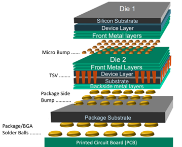

Definition and Core Principles of 3D-ICs
3D-IC Vertical Stacking
A 3D integrated circuit (3D-IC) is a system composed of multiple active silicon dies stacked vertically and interconnected through fine-pitch vertical interconnects. Unlike traditional 2D integration, which spreads functionality across a single plane, 3D-IC technology bring logic, memory, and accelerators into tight physical proximity.
Core architectural principles include:
  • Vertical Interconnects: Shorten communication paths, improving bandwidth and reducing energy per bit.
  • Heterogeneous Integration: Combine dies from different process nodes or foundries to optimize performance and cost—for example, advanced logic with mature I/O or analog technologies.
  • Chiplet Modularity: Partition large systems into smaller functional dies for improved yield and design flexibility.
  • Improved Memory Locality: Vertically aligned compute and memory reduce latency and power overhead associated with off-chip data movement.
Together, these principles extend the industry’s ability to scale systems without relying exclusively on transistor miniaturization.

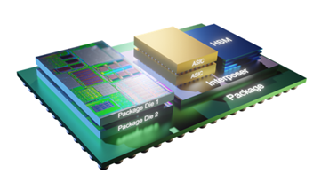

How Vertical Stacking and Chiplets Work Together
Two complementary approaches—vertical stacking and chiplet integration—enable 3D-IC architectures to achieve high performance, flexibility, and efficiency.
Vertical stacking takes integration further by physically aligning these dies in three dimensions. Memory or accelerators can be placed directly above compute tiles, dramatically reducing interconnect distances. The result is higher bandwidth, lower latency, and lower energy per bit—key benefits for data-intensive applications.
Examples of the :
  • Compute units stacked beneath memory to reduce off-chip data transfer.
  • Mixed-node integration combining high-speed logic with power-efficient analog and I/O technologies.
  • High-bandwidth memory (HBM) stacked on GPUs and AI accelerators, where vertical data channels deliver massive bandwidth at lower power.
Together, chiplets and vertical stacking form the foundation of today’s scalable multi-die systems.
