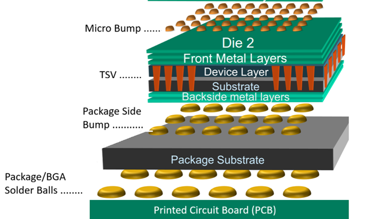

TSV Structure, Pitch, and Electrical Behavior
TSV StructureA TSV is fundamentally a vertical metal plug, usually copper embedded through the thickness of a silicon die. The classic fabrication flow includes deep reactive-ion etching (DRIE), liner and barrier deposition, copper electrochemical deposition, and backside thinning to expose the vias. Depending on when the via is introduced in the process flow, TSVs are categorized as via-first, via-middle, or via-last, with via-middle being the most widely adopted for high-density logic-memory stacks.

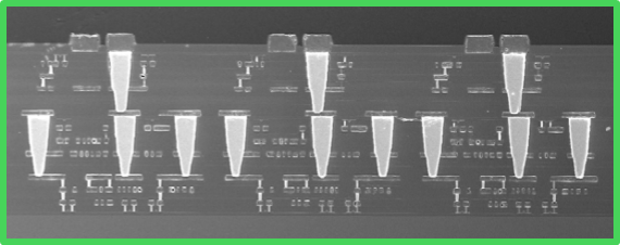

TSV Pitch and Density
TSV Pitch and DensitySource MIT LL
TSV pitch is a critical parameter that directly affects system design choices. A tighter pitch enables more vertical interconnects per unit area, supporting higher bandwidth between stacked dies. However, reducing pitch increases several challenges:
  • Higher parasitic coupling between adjacent TSVs
  • Greater mechanical stress due to dense metal insertion
  • Larger aggregate KOZ regions that reduce placement flexibility
As a result, TSV pitch selection becomes a joint optimization of electrical performance, mechanical reliability, and physical design constraints.

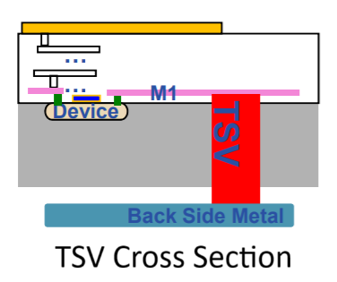

Layout Considerations: Keep-Out Zones and Stress Effects
TSV insertion dramatically reshapes the physical layout of a die. Unlike metal interconnects that reside in BEOL layers, TSVs cut vertically through active silicon—requiring strict layout rules.
TSV Cross-Section
Keep-Out Zones (KOZs)
Every TSV requires a keep-out zone, an exclusion region where no active devices or sensitive interconnects can be placed. KOZs are essential to prevent doping distortions, mobility degradation, leakage shifts, and stress-induced transistor performance variation. The TSV KOZ size is typically influenced by TSV diameter and pitch, process node, and substrate mechanical properties. In Cadence design flows, the KOZ regions are automatically created during TSV generation, with placement blockages inserted so that standard cells and routing remain outside the constraint boundaries.
Stress and Mechanical Reliability
Copper has a higher coefficient of thermal expansion (CTE) than silicon. During temperature cycling—whether during fabrication, bonding, or operation—copper expands and contracts differently from the surrounding silicon. This induces localized stress, which can shift transistor characteristics, cause delamination or cracking, increase timing variability, and impact long-term reliability.

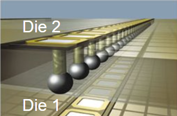

Bandwidth and Latency Implications vs Micro-Bumps
TSVs are often compared to micro-bumps, especially in the context of 2.5D interposer designs and conventional die-to-die bonding. The fundamental advantage of TSVs is the much shorter vertical path length, typically tens of microns compared to hundreds of microns for micro-bumps.
Bandwidth
  • TSVs enable significantly higher vertical bandwidth density because they support more parallel connections in a smaller footprint.
  • Memory stacks such as high bandwidth memory (HBM) rely on dense TSV arrays to achieve multi-Tb/s bandwidth per stack.
  • Micro-bumps remain viable for chiplet-style interfaces across interposers but cannot match TSV density for true vertical stacking.
Latency
  • TSVs provide lower interconnect latency due to their short path length and reduced RC delay.
  • Micro-bump interconnects introduce longer paths and additional parasitic layers, increasing latency for high-performance compute workloads.
Thermal Considerations
TSVs can double as thermal conduits, helping extract heat vertically—micro-bumps do not provide the same thermal advantage. However, TSVs also introduce thermal stress, requiring balanced placement strategies.

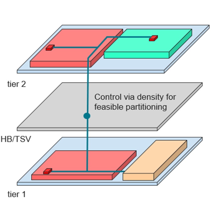

TSV Budgeting in Early Stack Planning
Engineering teams must determine their TSV budget early in the 3D-IC planning phase. This number influences die size, partitioning strategy, bandwidth goals, and overall package economics.
Key budgeting considerations include:
  • Signal TSVs: For memory channels, cross-tier nets, and wide datapaths
  • Power TSVs: For vertical power delivery networks
  • Thermal TSVs: For heat extraction in high-power logic stacks
  • Redundancy TSVs: For yield enhancement and reliability
Cadence’s Integrity 3D-IC Platform workflow supports hierarchical planning, enabling architects to experiment with TSV counts, pitches, and placements while simultaneously analyzing thermal, electrical, and mechanical impacts. Early co-design between die, interposer, and package helps avoid costly ECO cycles later.

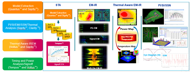

Verification and Reliability Concerns for TSVs
TSV-based architecture introduces verification requirements that differ significantly from 2D-IC design.
Electrical Verification
  • Accurate parasitic extraction of TSV arrays
  • Timing analysis incorporating cross-tier paths
  • SI/PI analysis for vertical power networks
  • EM-IR validation for TSV-intensive regions
Physical Verification
  • Rule checking for KOZ overlap
  • Minimum spacing between TSVs and active circuitry
  • Alignment verification across stacked dies
  • Layer-to-layer connectivity checks
Reliability Verification
TSVs bring long-term reliability considerations such as:
  • CTE-induced fatigue
  • TSV liner cracking
  • Copper pumping
  • Stress migration
Cadence’s multiphysics engines help engineers perform thermo-mechanical reliability checks within a unified environment, reducing fragmentation across EDA tools.
