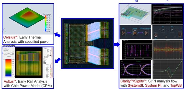

Electro-Thermal, SI, PI, EM, and STA Signoff in One Loop
3D-ICs introduce new challenges in thermal behavior, power delivery, and high-speed signaling due to the proximity of vertically stacked dies. Addressing these challenges requires multiphysics analysis to be performed early and repeatedly throughout the design cycle. Cadence meets this need with a unified signoff loop that integrates thermal, electrical, timing, and electromigration analysis.
The Integrity 3D-IC Platform is directly linked to specialized Cadence solutions, including Celsius Thermal Solver for thermal analysis, Voltus IC Power Integrity Solution for power integrity (PI), Clarity 3D Solver for 3D electromagnetic (EM) extraction, and the Tempus Timing Solution for timing signoff. All analyses are performed on the same stack database used for implementation, eliminating manual handoffs, redundant data translation, or inconsistent geometry models.
3D-IC SI PI
When issues arise, such as thermal hotspots or power distribution network (PDN) resistance bottlenecks, designers can adjust placement, bump configurations, or power grid structures and rerun analysis rapidly. Because this loop is fully integrated, engineering teams gain early visibility into multiphysics risks and reduce costly, late-stage surprises.
