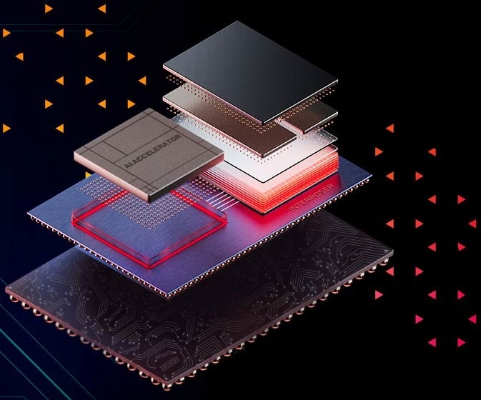

3D-IC Packaging: Wafer Stacking, Hybrid Bonding, and Interposer/RDL Techniques
4 Dec 2025 • 7 minute read
The semiconductor industry is entering a new era where transistor scaling alone can no longer fuel performance gain. With AI accelerators pushing beyond 2–5TB/s of die-to-die bandwidth, hyperscale systems demanding higher compute density, and mobile devices requiring extreme power efficiency, advanced packaging has become the new engine of system innovation.
3D-IC Packaging
Industry forecasts indicate that the 3D-IC and advanced packaging market will exceed USD 89.9B by 2030, growing at 11.7% CAGR driven by chiplet architectures, silicon interposers, and 3D stacking in memory and logic devices. In other words: packaging is no longer an afterthought—it is the architecture.
This blog breaks down the major 3D-IC packaging methods used today, from wafer stacking flows to hybrid bonding, interposer choices, and package-aware design, and examines how engineers evaluate tradeoffs in density, cost, manufacturability, and reliability.

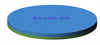

Wafer-to-Wafer (W2W)
Wafer-to-Wafer (W2W)W2W bonding provides the highest throughput but requires matching wafer sizes and similar yields on both wafers. This makes it ideal for:
  • Memory-on-memory stacks (e.g., 3D NAND)
  • Logic-on-memory configurations with tight alignment
  • High-volume applications where wafer-level yields are predictable
Its main limitation is yield-loss multiplication; one bad die can compromise an entire bonded wafer pair.

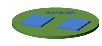

Die-to-Wafer (D2W)
Die-to-Wafer (D2W)D2W bonding enables the placement of known-good dies on a target wafer, thereby dramatically improving yield for heterogeneous stacks. It's suited for:
  • High-value chiplet integrations
  • Logic-on-memory with dissimilar die sizes
  • Cases where each die has a different reticle or process node
This method improves overall stack yield but is slower than the W2W method.

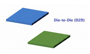

Die-to-Die (D2D)
Die-to-Die (D2D)D2D bonding is used when individual chiplets or small dies need extremely tight placement accuracy. Advantages include:
  • Highest placement flexibility
  • Ideal for high-performance chiplets
  • Compatible with both micro-bumps and hybrid bonding
D2D is the most flexible but also the most throughput-limited assembly flow.

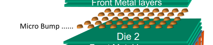

Micro-Bumps
Micro-Bumps
Micro-bumps remain widely used for:
  • 2.5D interposer systems
  • Early-generation chiplet architectures
  • Die stacks that require mechanical compliance
Typical bump pitches range from 35 to 55 µm, with emerging processes nearing 20–25 µm. While reliable and OSAT-friendly, micro-bumps introduce:
  • Higher parasitics (R, L, C)
  • Larger pitch and lower density
  • Solder-joint fatigue risks

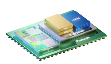

Packaging Choice Matrix: Balancing Performance and Cost
3D-IC Vertical Stacking
A decision matrix helps teams match their architecture with manufacturing realities.
Requirement
Best Option
Why
Maximum interconnect density
Hybrid bonding
Lowest pitch, lowest RC parasitics
Best yield for heterogeneous dies
D2W or D2D
Uses known-good dies
Lowest substrate cost
Organic RDL
Panel-scale, low-cost materials
Premium performance + density
Silicon interposer
High routing density, strong SI
Emerging cost/performance balance
Glass interposer
Low loss, dimensional stability
Best thermal pathways
Hybrid bonding + TSVs
Cu-Cu stack improves heat spreading
A straightforward comparison enables faster architecture decisions and more predictable assembly outcomes.
